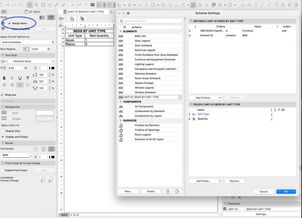

This approach might work for your purpose, using AC’s zone built-in capability to count the objects within it:

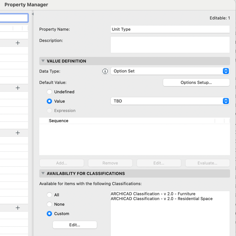

a.  You can create a custom property that will act as a grouping value for room zones and objects (e.g., Apt Type).  It should be made available for both zones and objects.
b.  You can select and assign the room zones to the appropriate group/s (e.g., ‘Azure’, Bayou’, ‘Coral’, etc.)

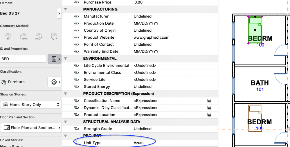

c.  Then, similarly assign the desired objects (e.g., beds) to the same group/s, so they match the zones they are within. This effort is a bit redundant, but in this way the objects will be captured in the schedule by their group value.)
d.  Schedule the results:  the criteria will be set to retrieve the objects (e.g.,“Bed”). The schedule fields will include the group value, room zone ID to list each room under the group (Apt Type) if desired, then the General Parameters ‘Quantity’ to produce the assigned object count. Checking ‘Merge Items’ will tally the objects within.
Hope this helps.

In the schedule I described, if you only assign the beds to the apartment type, then it will only show the beds. Alternately, you can restrict the furniture to the bed ID, LP, or other field in the criteria.

Here are some screen shots of the steps I used and the resulting data.
Note:  I have a "PROJECT" group for my custom properties (such as this one) in the Property Manager, instead of putting them under the default AC headings.  I just find it easier to find and manage them in one place.
