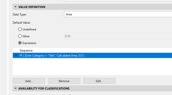

Well after decades using listing...one of the best but cubmersome features, I am trying to migrate stuff to using properties which the first couple of tuts...well it couldnt do it without fudging eg Room Illumination...but thats another issue (you CANNOT easily run priced BOQ from properties
I am simply trying to do the following but Im not getting something about the flow of datatypes and its certainly not obvious or friendly from my perspective but maybe its the siltation from listings
1. I choose area datatype and do a basic if statement to extract gross site area from a zone
Error!

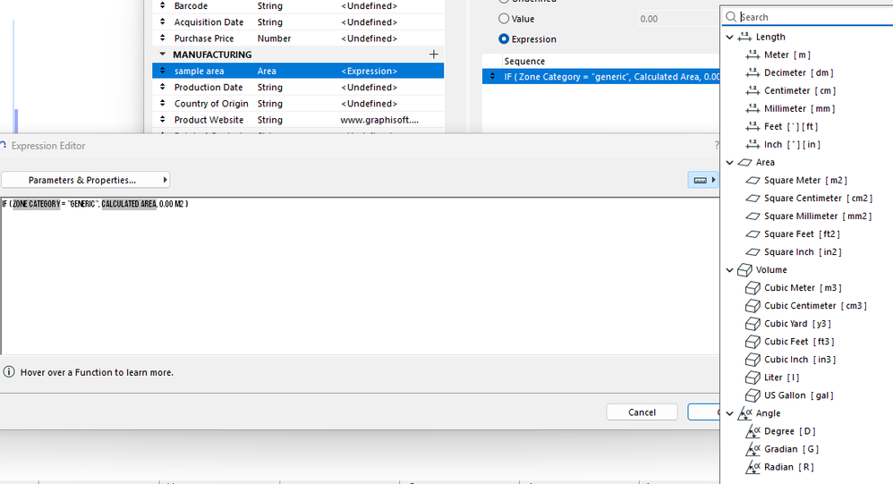

HI.. YOU need to include area unit to 0.00 value.. e.g 0.00m2 , or 0.00ft2,etc  in order to match all your variable types.

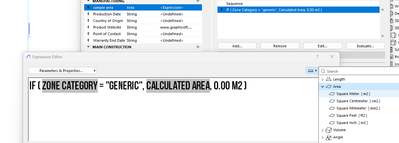

It is just a small thing but easy to miss - the units for all outcomes must be an area.
IF (Zone Category= "Site", Calculated Area, 0 m2 )
If the zone category is not "Site", then it must be 0m² and not just 0.
23 REPLIES 23

ok but you dont have to cast the type though right? ie 0.0
I thought GS always used FP which is why FP = FP was always a no no

FYI: To add to which everyone has already said: In any expression, Archicad first error checks the expression by first checking that all return values are applicable  (classified) for the intended element type, then checks if all return units match that selected as the return unit. If any variable fails, the expression is deemed invalid. It does not matter if a variable can not be reached in the logic.
There are also occasions when you just want to return a number, as in returning a calculated currency value based on area or length, etc.. In that case, you simply divide out the final unit to return no units. i.e. (area m2/ 1 m2) -- returns just a number. Archicad does not have a currency unit -- so you have return a number or convert it to a string
