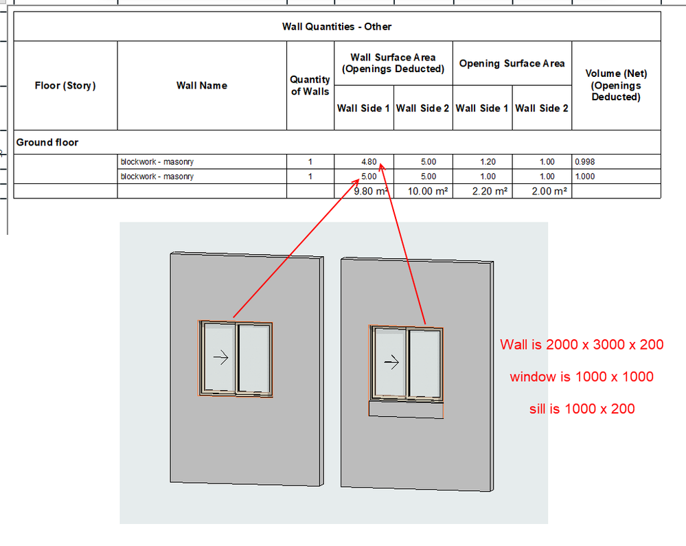

All you can get is the opening areas which does not help - you need just the sill area.
So from the wall you can get number of MCU400.400 blocks (based on the net wall area or volume).
From the window you can get the number of MCU200.200 blocks if they are needed (based on the window height).
Unfortunately the wall can not interrogate the properties associated to the windows (as far as I know).
You could schedule the block property (either area, volume or actual number of blocks) from the wall and the bock property (either area, volume or actual number of blocks) from the window  - possibly in the same schedule (I can't say I have tried) but definitely in separate schedules.
But even if they are in the same schedule, they would be different fields and therefore can not be summed, subtracted or totalled.
All I can think of is to include a half block sill for those windows that require it.
If the sill is modelled as part of the window, the overall area of the opening and sill will be deducted from the wall, so you can get accurate quants of the MCU400.400 blocks and create a schedule for that.
Then you can get schedule accurate quants of the MCU200.200 blocks from the windows.
So 2 separate schedules, but that should be OK as they are 2 separate materials.
Example of the sill area being deducted ...
