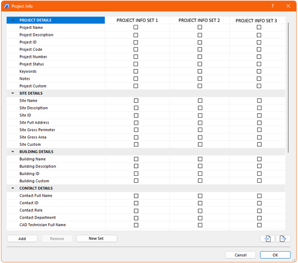

Great question @Miha_M thanks for posting it. I fully understand why you ask for this.
Some time ago I also posted a wish for the same aspect, but for a different (additional) reason.
Wishes - New Feature Request for BIMx (Project Info control)
What I suggest is better control of project info directly INSIDE Archicad, because we experience TOO MANY .xml file corruption errors exporting & importing Info sets. These persistent errors cause a lot of delays, especially during Publishing in extremely tight deadlines. The exporting & importing Info sets process is buggy and we can not trust it.

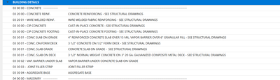

I have a different end goal...but would also like the ability to adjust Project Info much more than currently allowed.
Currently, we are trying out having all of our typical Section notes already established, and then using basic autotext for Wall Sections & Details where we can't pull everything directly from the model (Building Materials or element ID's).
The massive benefit here is that we change a note in this single "Project Info" location, and all the autotexted labels will update for the entire project.
Unfortunately, I cant Create an additional header for each division, so "Building Details" ends up containing what will be a massive amount of typical pre-established notes.

Note these suggested options with images (below) for expanding Project Info on my post: Wishes - New Feature Request for BIMx (Project Info control)
As we solve Property Compliance for owners, landlords & their tenants, we use BIMx as an easy to use, entry level platform to access their "Digital Twin" for various stakeholders that each need to have an applicable level of access to info in the model. I believe control of "Project Info" visibility is not that far removed from where Graphisoft is taking BIMx looking at the exciting roadmap & recent BIMx improvements. Properties does not work in this case. I remain hopeful... have not given up on my posted wish for improved Project Info.
Constantly importing / exporting various Project Info data is messy, time consuming and very open to software & operator error with varying Archicad proficiencies in a studio environment.
