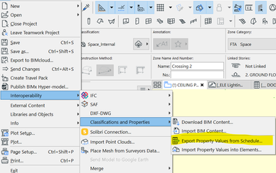

The workaround I am currently using is:
- I created a schedule all all doors & windows and the critical properties for them,
- I then periodically export this schedule through File>Interoperability>Classifications & Properties> Export Property Values from Schedules..
- This save as an excel file, essentially as a backup and then I can use the Import Property Values into Elements.. to restore the data.
It's not perfect as you have the real risk of overwriting changes made by other users, but at least it's something.

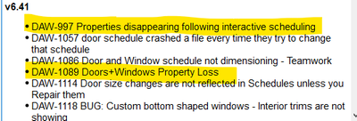

I just stumbled across this in the CI Tools Door and Window change log.
What version of the addon were you guys running?
I'm pretty confident ever since I deactivated the addon on my projects I've not had any issues with properties disappearing.
I've requested further info from CI to confirm these bugs were the cause of the issue.
