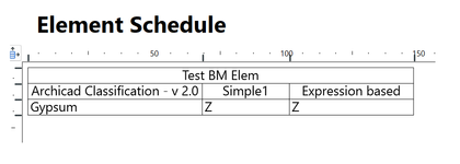

The expressions are not working when using for Building Material properties.
It shows <not applicable> in the Property value  (In this example the expression only contains a property which is used for the same building material).
It shows no value in Component Schedules (see attached screenshot).
For Element Schedules the expression works (see attached screenshot).

Properties apply to whole elements but not to sub-elements; this is the level at which the functionality is currently implemented.
There is a relevant wish in the Wishlist about this feature:
https://community.graphisoft.com/t5/Wishlist/Need-of-component-properties-in-expressions/idi-p/63230...
