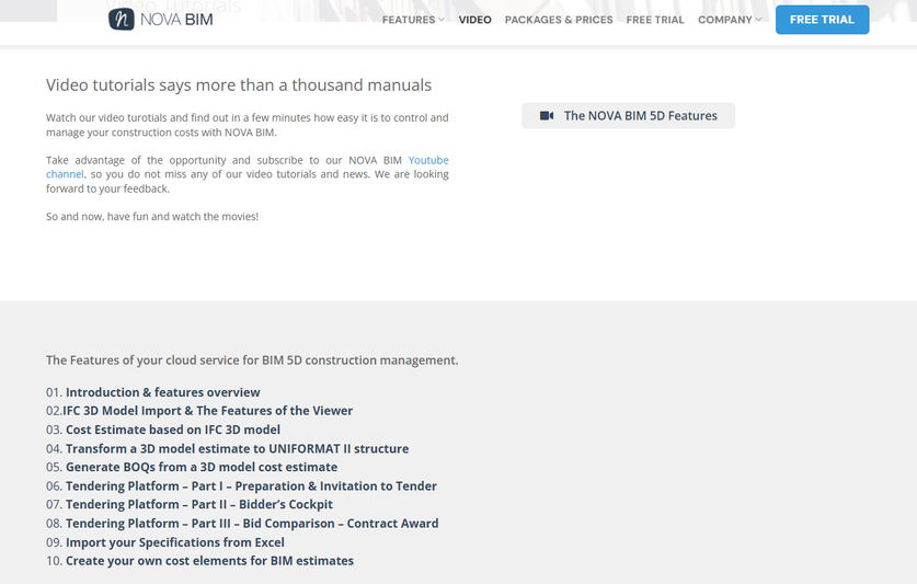

Hi, If you think of OpenBIM, I would suggest explore NOVA BIM 5D.
Please, check if, it fits your requirement.
Weblink: https://novabim.lt/en/
