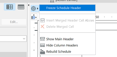

I am using Archicad 27 on a teamwork project and finding that the schedule tool is being a bit glitchy.
1- I set the schedule to Freeze Schedule Header. When I close and reopen the project. The setting reverts back to having this switched off.
2- On a Layout I set the Drawing view of a Schedule to Restructure Table. This setting also reverts back to having this switched off when I close and re-open the project.

Can you try something?
Can you save a PLA file of the Teamwork Project, and then open that file in Archicad just for testing purposes, save it as a PLN (libraries can be read from the PLA file), and make these changes in that Solo Archicad file. Then save, close, reopen. Do the settings stick then?
If they do, then this may be a BIMcloud thing as it does not happen in a Solo file.
If they still don't stick, then it may be an Archicad thing.
