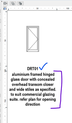

perhaps i'm missing something, but is there a way to have different text formatting between different cells in a schedule?
DRT01 is correct (blue check)
but i want the description below it to be a smaller font size & not bold. seems pretty basic & i'm almost too embarrassed to ask.

Cells of the same type must all be the same.
i.e. values, headers, totals, etc.
In 28 you can add colours to cells and alternate colours (stripes) to values.
But there is no formatting of individual cells.
