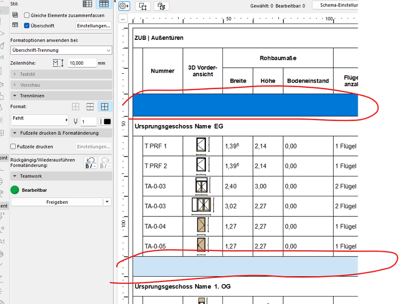

I have changed many settings in my Schema and now some rows appear that I can´t delete, because I don´t know where they belong even.
Any idea?

There’s an option which adds an empty row before every headline. Check if that’s activated. You’ll find it under the headline settings in the side panel, "Überschrift" → "Einstellungen" in your screen shot.

Yesss, you are right! Thank you.
