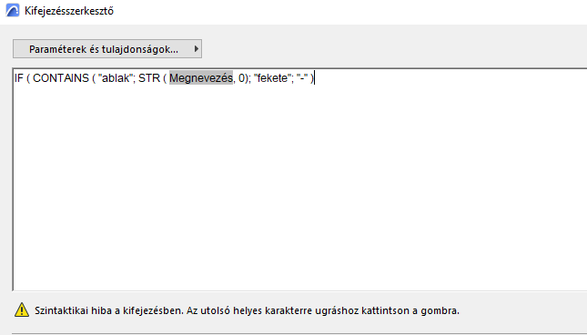

Hi everyone,
I recently started trying to write functions in Archicad.
Can you help me where is the error in the following function?
Thanks in advance for your help.
1 ACCEPTED SOLUTION
Solution
Try a ; (semicolon) character after "Megnevezés" instead of a , (comma) character. You always have to use the same character everywhere in expressions, depending on your operating system settings.
In English language operating systems, . (dot) is used as a decimal point character, so in the Expression editor you can use the , (comma) character.
However, in some other language operating systems (like Hungarian), the , (comma) is used as a decimal point character, so in the Expression editor you have to use the ; (semicolon) character.
1 REPLY 1
Solution
