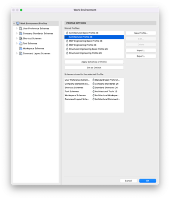

The Default Profile in the list is the one with a checkmark ("Architectural Profile 26" in the image below; your factory-shipped default may vary). In the Work Environment dialog box, you can set any other profile to the default. Other available profiles are listed at the bottom of the pop-up. Some of these are predefined and shipped by Archicad; these are locked.

1st level - Work Environment
This is the upper level - Here you can create and save the individual Profiles

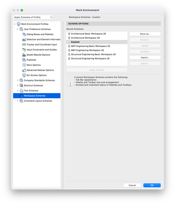

Saving the position of the palettes
  1. You can define the palette position manually in the Archicad main window by dragging the palettes to a desired position and opening, closing, or hiding them.
  2. Open the Work Environment under Options > Work Environment… and click on Palette Schemes. Here you can see a new entry “Custom”.
  3. Select this entry and click on Store as… to save this modification and add a new name to it. At the bottom of the page, you can see the message
    "A stored Workspace Scheme contains the following:
    -Tab bar appearance
    -Palette and Toolbar size and arrangement
    -Docked and undocked status of Palletes and Toolbars"
    This means that the arrangement of the palettes you have set and it is displayed will be saved. Now a new Palette Scheme appears, and because it is the active scheme it is marked with bold letters.

  2. Collect together the new Schemes into a Profile.
    Go to Work Environment Profiles (first level), and on the right under the Profile Options, you can create and save a New Profile…
  3. Name your new profile e.g. QuickHelp, in the forthcoming dialog. And below you can choose the previously created (and saved) Schemes.
  4. After you set these options close the window with OK.
  5. The new Profile appears among the Stored Profiles. Selecting it and clicking on the Set as Default button gets a black check mark showing that Archicad will start always with these settings.
  6. To use this profile immediately double-click on its name and confirm the dialog by clicking on Apply.
