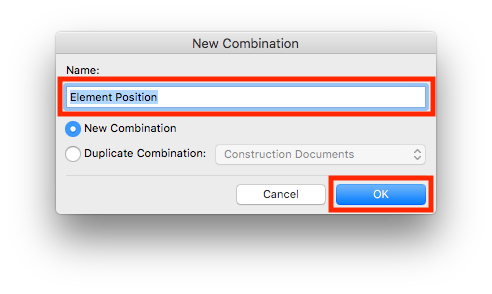

2. In the Graphic Override Combinations dialogue box click New...
3. In the New Combination dialogue box, name the new combination and click OK.

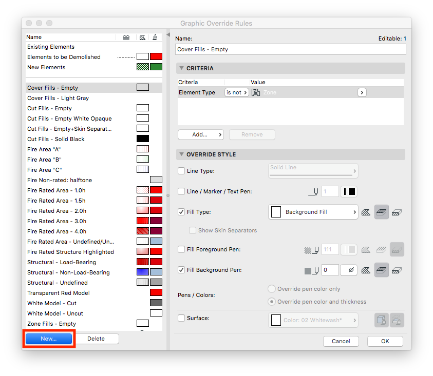

4. Click Edit Rules...
5. In the Graphic Override Rules Dialogue Box, click New...

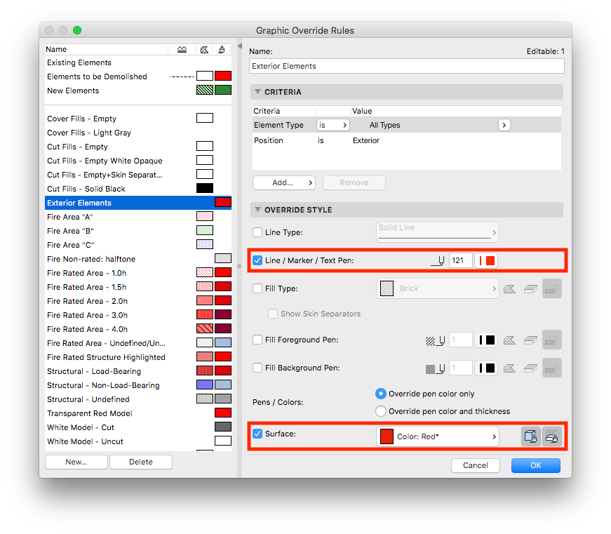

7. Select the newly created rule for exterior elements and set the Criteria to Element Type is All Types and Position is Exterior.
8. Under the Override Style tab click the check box next to Line / Marker / Text Pen and choose a pen. Then check the box next to Surface and select a corresponding color.

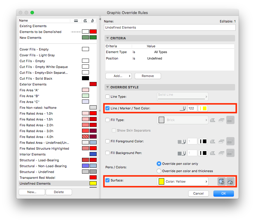

15. Select the newly created rule for undefined elements and set the Criteria to Element Type is All Types and Position is Undefined.
16. Under the Override Style tab click the check box next to Line / Marker / Text Pen and choose a pen. Then check the box next to Surface and select a corresponding color.

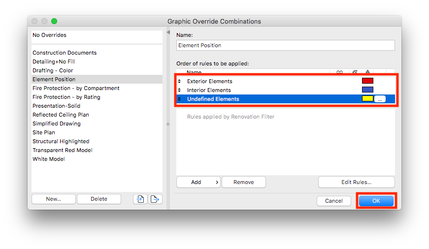

17. Click OK to return to the Graphic Override Combinations dialogue box.
18. In the Graphic Override Combinations dialogue box click the Add button, select the newly created rules and click OK.

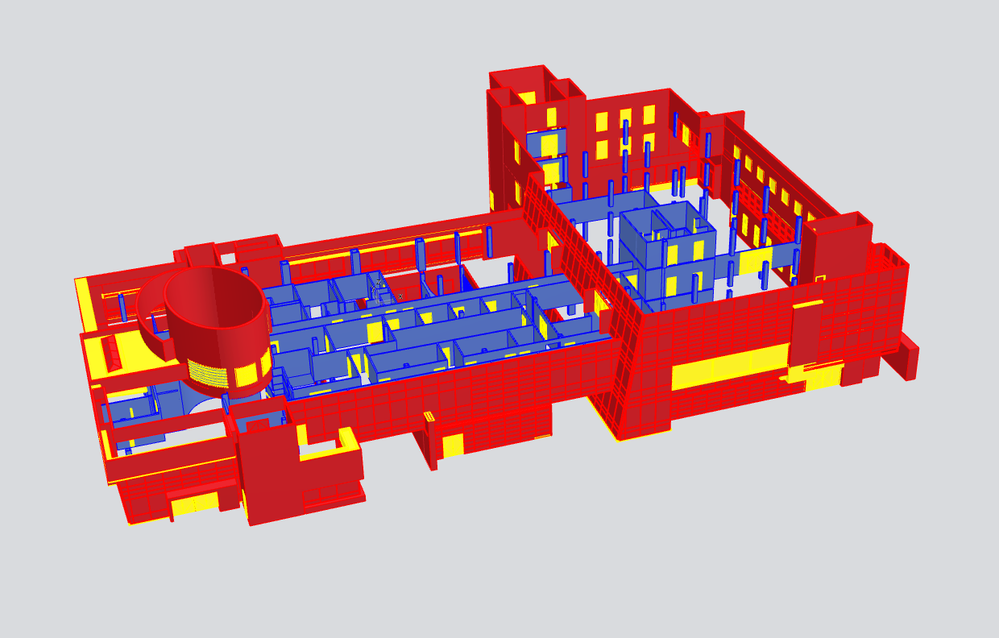

19. Apply the new Graphic Override Combination to identify the position of elements within the project.
