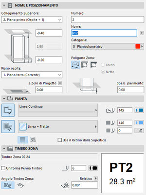

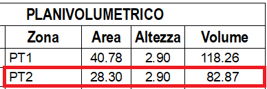

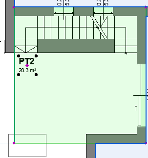

I'm using zones to calculate the whole volume of the building. For example, this volume should be 82.07m³.
Criteries are
- Element type = zone;
- Layer = (the objcet layer I'm using).
Fields are
- Host story name;
- Zone name;
- Measured area;
- Height;
- Net volume.
