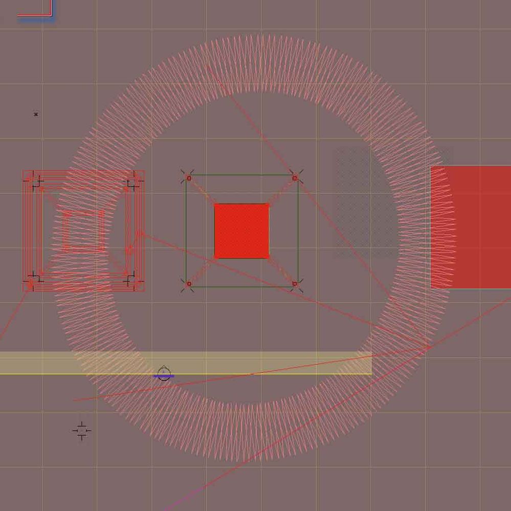

Every body probably knows this but I found that you can get true
transparency in Archicad by drawing a rectangular a radial gradient fill
and stretching the concentric circles outward beyond the limits
of the figure you want to cover with transparent fill. The attached
image was made with this method and does no employ percentage fills.
Peter Devlin
With a little more experimenting, it turns out that these
gradient fills are not quite true transparency. If you bring
the fill to the front it will obscure the lines behind it.
Peter Devlin
