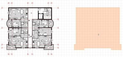

1. This is my floor plan example.
Red zone on right is a gross zone what I need to be calculated.
Zones inside floor plan on left side need to have visible just numbers, nothing else, something I have done already.

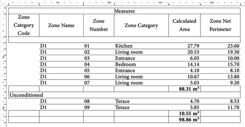

2. This is what I have achieved so far, but this is just for net areas and not all how I need it.
This is a schedule in general ok sorted in terms or culumn. I need to have Apartment named D1 all rooms group together (sorted with numbers from 01-XX) like in picture above, but I cant achieve living rooms (from 1-9 to get subtotal) and terace ( 8,9 subtotal) than full D1 total. Last row perimeter must not have total calculated.
Also I have Communications and Staircase zone not in right places in schedule- they need to be at bottom at the end of all apartments with zone numbers etc 01 for communications and 02 for staircase and total for that 2 zones, just for communications and staircase of net area.

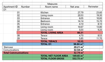

3. At the end I search for table to look like this.
I exploded my schedule and manually did all the work to show you what I need as final result (but just for D1, and I also need for J1, J2, but as for now I didnt do that because of lack of time, but this shows the point)
It is important to have this red rows for every apartment from the floor plan (D1, J1, J2) divided and to look like in picture from below, than to have all apartaments + staircase + communications Total net area and at the end Gross area row (marked green).
Maybe I use wrong parametes, wrong fields, wrong everything from the start, but I really need help from someone to get this right in my file and tell me what he did and why so I learn and use that as a template for everything afterwards. Is there any hope for me or I need to to this measures table manually for hours and hours and loose time by drawing lines and text tool manually with calculator in my hands to do the calculations.

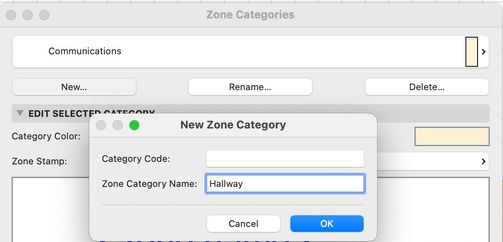

The easiest first step after looking at your file where you have a zone called Communications for your hallway, is to realize that you can create any number of zones to meet your needs.  [Re-reading your post, it sounds like Communications might be the correct name in your country anyway though.].  In the Zones attribute dialog, just click the New button to create a zone for Hallways, perhaps one for Stair Wells, etc - whatever level of detail you need.

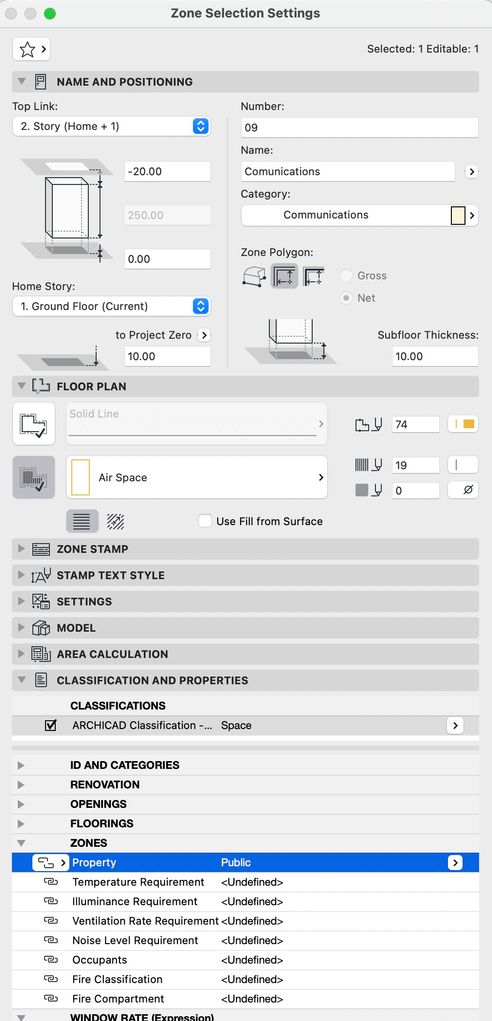

If you look at the settings for each placed zone, you'll see a number of available Property fields.  These are what I see in the USA version:
Any of these can be unlinked from their default 'undefined' value by clicking the first chain button - and then either selecting from a pre-defined option or typing text.  Each of these fields is available in the schedules to both filter (Criteria) which zones appear in the schedule... as well as to simply appear as a data column, or have the corresponding zone areas grouped or subtotaled.
In the screenshot, I unlinked the Property field and selected 'Public' from the drop down... I would use this setting for the hallways, stairwells, lobby etc zones.  For all of the zones within an apartment/flat I would select the 'Private' value.  With just this one property, I could then generate a short schedule comparing net (or gross depending on zone shape) public vs private space along with total area.

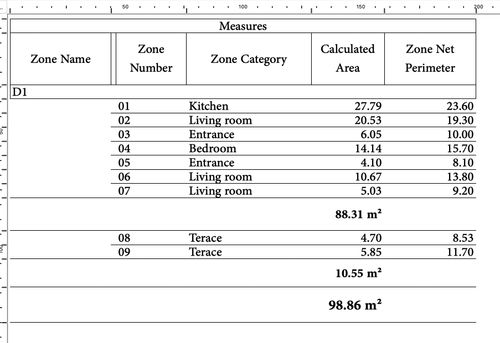

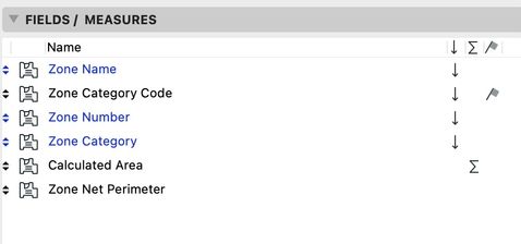

For example, here is a quickie with one tag to group the living vs terrace space of apartment D1 (criteria set to only show D1)... first with the category column visible, and then reduced as small as it can go to hide the grouping column.
I moved the Zone Category Code to the right of Zone Name so that I could 'headline' Zone Name and not have the D1 repeat on every row... but you'll notice the side effect is the two vertical bars for this 'missing' column.  Archicad used to let us set the column width to zero so that only one vertical line appeared here.  I can't set it to less than 2 (whatever the units are) now.

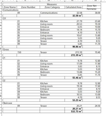

This is where I'm now.
I just used for me the fastest way to achieve the required result.
I recreated zone names (creating new or renaming it in Zone category window) with Assigned number for Zone Category name. So for every room inside apartment I added parameter 01, and for all terrace's I added 02, for Communications (we call it like that) I added 03.

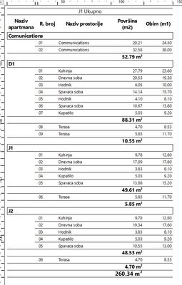

Now my schedule looks like this. Which is not ok. So I added category criteria just to select for apartment D1, J1, J2 ( this means I created 3 schedules). Here is just for D1.
And this is 50% ok for me, because I still do job a lot faster and precise than manually before.
