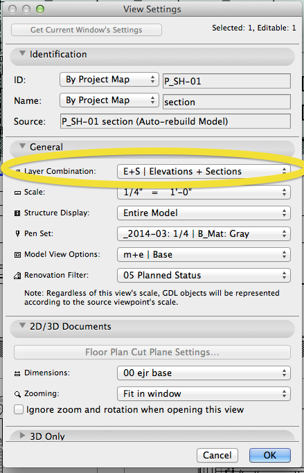

It is something you can do after the Views are placed on the layouts. To assign a Layer Combination to different drawings.
Right click on all the drawings either by page or using Navigator View map and edit the Layer Combination

Eduardo Rolon
Edit this to choose a different Layer Comb

Create a layer combination with all the original layers of the sections except without the furniture layer and then go to the modify source view settings dialog and select the new layer combination there?
