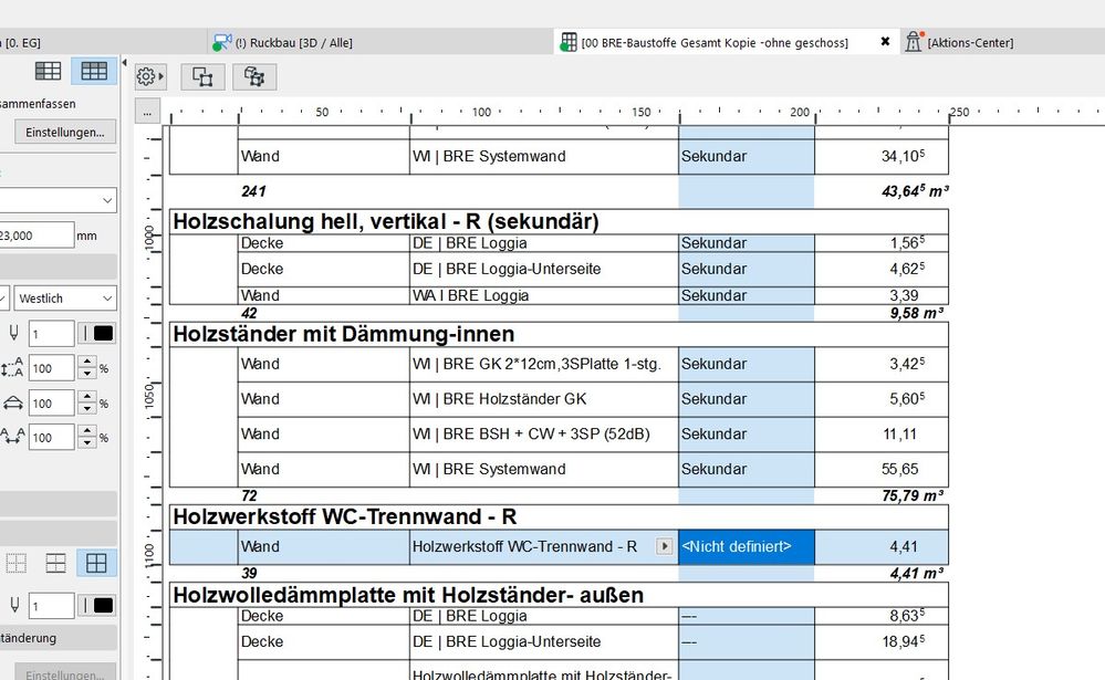

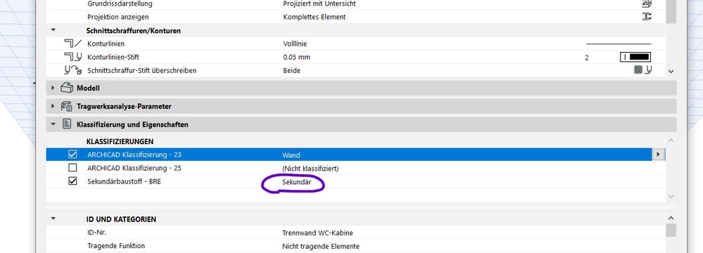

I added a new property in Archicad so that I can add elements to "new" or "sekundar" classification.
Somehow on the list some elements that are in "sekundar" classification category it shows as: "not defined".
Even if I change that property to new, nothing changes.
Is it possible that there is some Archicad bug or did I do some mistake somewhere?
Thank you

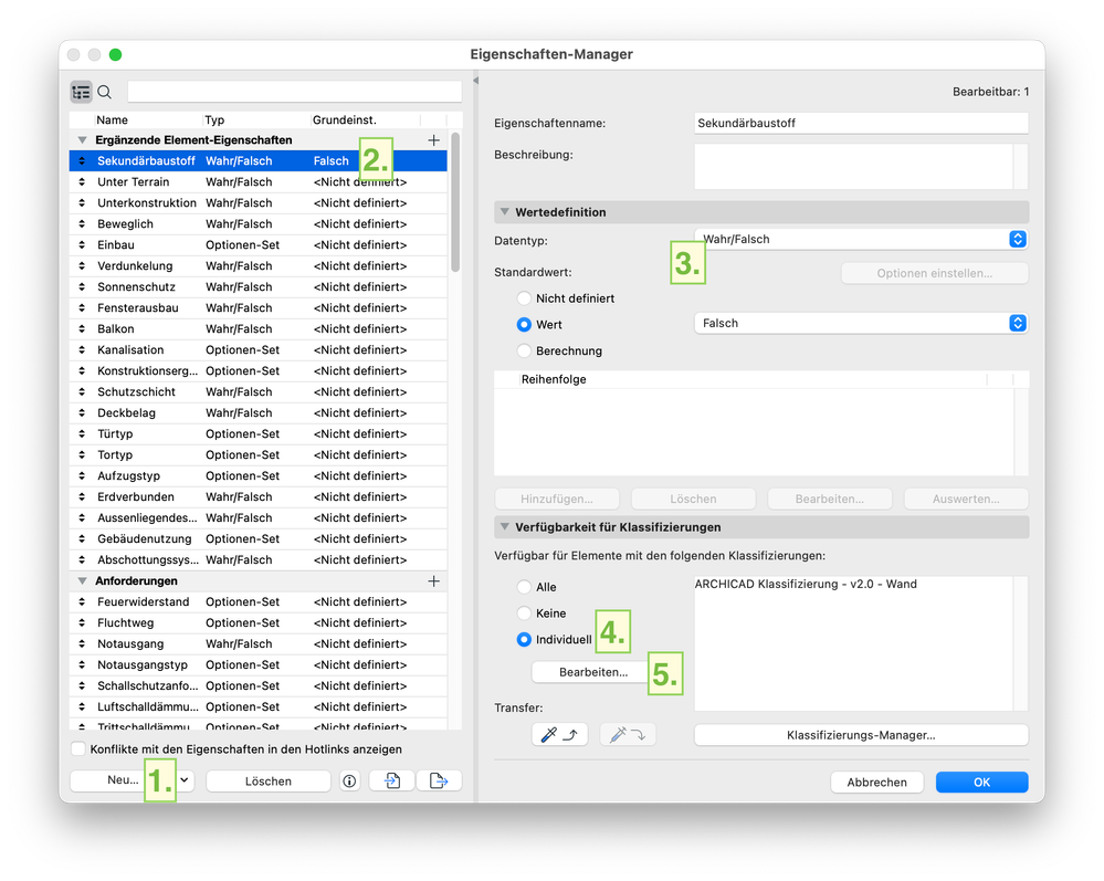

Hello tjasa
No idea why it's not working. But I would maybe rather use a real Property ("Eigenschaften-Manager") and not a Classification ("Klassifizierungs-Manager"). Be careful to assign the property to your classes (screenshot pt. 5).

Thank you for your reply! To avoid issues, I will use Eigenschaften-Manager next time. For now I just exported the list to excel and adjusted it there. 🙂
