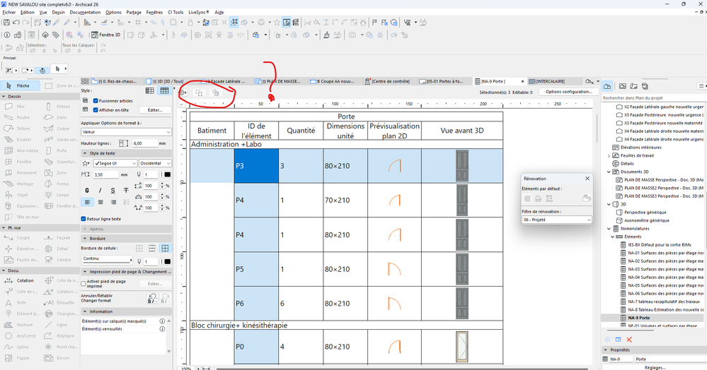

i would like to know why it don't allows me to click it . Moreover , it consider orientation of door even if doors have same dimensions . How to fix it please
1 REPLY 1
The reason you can't select the doors is because you have the schedule open using a layer combination where the wall layer is turned off in plan/3D.
You should always open your schedules from a saved view, and that view should have the correct layer combination set so the wall layer is always on.
As for the separate handing of the doors - that is not the actual reason.

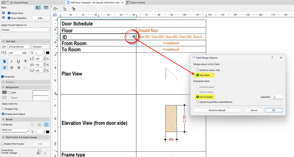

The reason is they have unique IDs (P4, P5, P6) and that is forcing them to list separately.
So they either all need to have the same ID or you can further merge the ID field.
