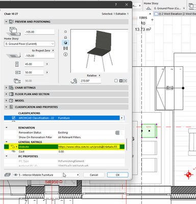

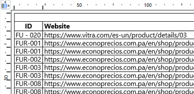

As far as I know URLs can be added as properties, displayed as labels and scheduled.

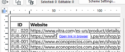

I get your point and it would be great. While that wish comes true, you can hover your mouse over the URL link in the schedule and an Open link in browser pop-up will appear. It is better than nothing. 😉
