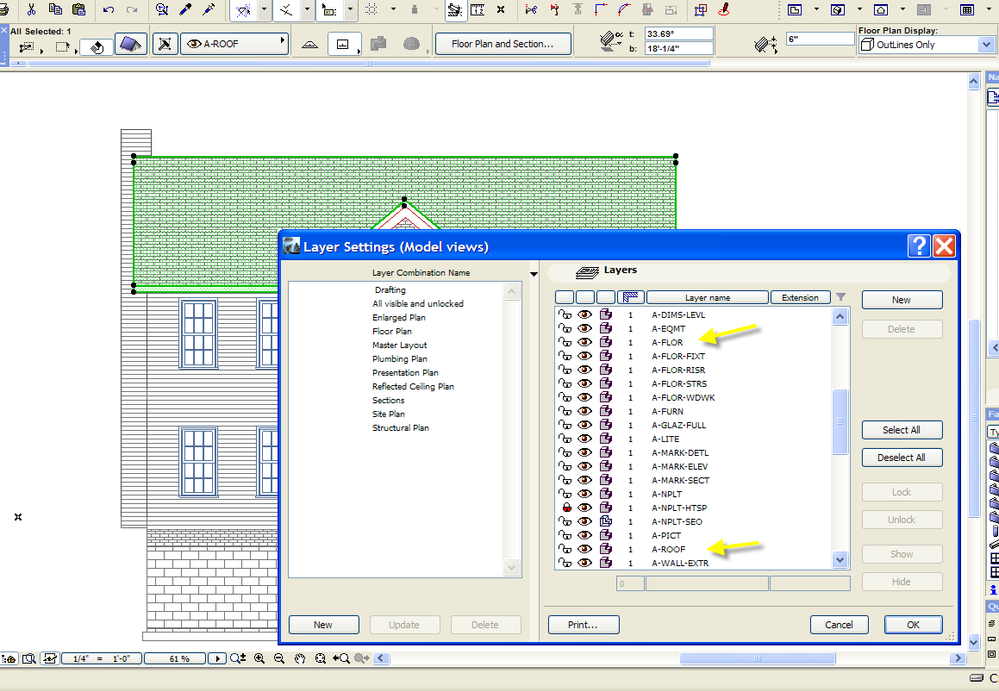

When I opened my plan, I switched to the front view and the Roofs, Floors, and the trim were all missing. Also on every other elevation. I checked to see if the layers were showing they were but still didnt show up in any elevation. I went to the plan and selected each element and switched them to wireframe then they showed up on elevation. Then did again to solid, that worked. Now I cant see any of those items in 3D. What should I try next or rather what am I doing wrong?
Thank You for your help
Brian

Works fine here. It's probably part of a bigger problem. You may have to upload a copy of the project. To squeeze it down you can use Attribute Manager to purge all unused attributes (All tab). You can also manually delete all layout info.
Still sounds like a layer problem to me - did you try this whilst navigating in the project map?

After looking at the file sent via email:
Ultimately I believe your problem lies with Solid Element Operations. It seems you may have accidentally instructed AC to use some of the roofs to use themselves as operators and targets, which results in them effectively cancelling each other out. They still remain visible in plan, but any 3D window (and that includes S/E's) they disappear, as they should.
To rectify this problem, I would select all the roofs on the roof story, open the Solid Element Operations palette and on the Maintenance panel under 'Cancel Operations of Selected Elements', hit the 'All Other Selected Elements' button.
Hope that solves the problem for you. If problems persist, let us know if you have any library part problems.

1. Elements can be targets as well as operators for different operations, but I think what you had done was somehow told the roof(s) to be targets and operators for the same operation. For example, if you use some roofs as targets and some of the same roofs as operators and did a subtraction operation, then those same roofs will cancel each other out.
2. Modules will lose SEO's between different stories, since all modules are single story only. Maybe you had some other SEO between other elements and your roofs too.
3. Again, you could have had an accidental SEO relationship between a slab and a roof. Without taking the time to go back and check the SEO Maintenance, it is anyone's guess what you've done!
I would suggest learning more about SEO and practice in a separate file. Follow the golden rule to make sure that you only ever use operators and targets that are absolutely necessary for that operation. A bad example would be to select all walls as targets and all roofs as operators for a subtraction with upwards extrusion. Sure it will work fine, but will also create many relationships between walls and roofs that will never be needed, especially if they are on the opposite sides of the building from each other. So keep them to an absolute minimum. Keep an eye on your Info box and your SEO palette as to how many elements you are using.
