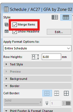

Hi there,
I was wondering if there is a way to change my window schedule settings so windows with the same size, window type etc. only show once in the schedule?
Thanks
Solved! Go to Solution.
3 weeks ago
Select this option to merge identical elements:
You can customise how merged items are displayed. It's explainedhere.

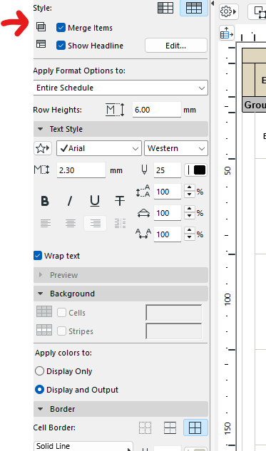

3 weeks ago
- last edited
3 weeks ago
by
Add a quantity field and be sure to check merge items in the schedule. They will merge and you will know how many identical items you have (quantity):
