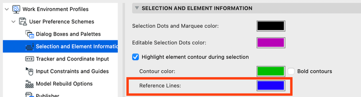

NateLumen
If you look in Work Environment > User Preference Schemes > Selection and Element Information ..... you can adjust the color of the reference line.

Gabor Szelei
Thanks for the answer.
Of course, I know about this setting option! But it only works if the element is selected.
I'm looking for a solution so that if the wall is not selected, but the reference line is turned on, the reference line is still clearly visible! I would like the reference line to be red in the above case.

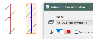

Stefan L_
Rockstar
The colour of the reference line (when not selected) is controlled by what was once called the 'primary pen', which is the cut contour pen for simple walls, but not for composite or profiled walls.
For composite/complex walls this pen setting is only accessible via CTRL-Shift-T (german version) or this button:

Gabor Szelei
Hello Barry & Stefan,
Changing the color of pen 1 doesn't work for me. It doesn't change the color of the reference line.
Do you see the reference line on the composite wall?
It's there, it just needs the right magnification.
That's why it would be good to be able to highlight the reference line with a clearly visible different color.
The solution suggested by Stefan works for composite walls, but unfortunately for simple walls it is not possible to change the color of the reference line compared to the color of the cut edge

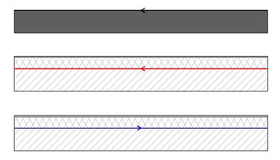

Gabor Szelei
Hello Stefan,
"But this story is my creed. 😇"
I'm glad, I'm not the only one, who goes against traffic on the highway 😁
Of course, the color is not important, since I am making a black&white plan, but in this one, a red reference line is clearly visible. ☝️
Why is it important that this is clearly visible? Because the orientation of the wall is important so that we can determine the outer/inner side of the wall...
I assign a lot of properties to a wall, be it simple or composite, some of which apply to the inner side, others to the outer side.
I would like to place the label for the inner side to the inner side, preferably so that it doesn't have to be flipped...
This would obviously not be necessary if it were possible to assign properties to a composite wall layer by layer, but this has been an insoluble task for developers for years...

Stefan L_
Rockstar
Wall direction? Then keep it straight! 🤣
Curved walls ALLWAYS go counterclockwise.
Inside/Outside is -again - a benefit of using composite walls, you could use blue = cold for the outside and red = hot for the inside. Well, depends on your local climate...
