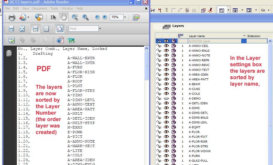

When I create a layer setup for a firm or am using someone else's file I print the layers from the layer settings box. I Make a pdf which I can notate or print. I start by having the first layer combination have all layers so the first layer combination listed is a list of all the layers.
In the last iteration or so when I print this, the layers in the pdf or printed directly to my several printers changes the order of the layers within each layer combination. They are now listed in the [numeric] order that each layer was created. This is not very useful. Like elements such as wall.int, wall.ext, wall.site etc are now not grouped alphabetically by layer name as I would like and expect.
The screenshot shows the layer settings box on the right and the pdf printed version on the left.
I've checked both my machines, a dell XP3 and mactel mbp on leopard with same results.
Why isn't it printing to pdf or hard copy correctly, as it used to?
Any thoughts on how to fix this or a workaround if it's not just me?

I don't recall if the Layers were ever listed alpha-numeric in the "Print" option, they were always listed by their index number - At least the last few versions that I have used this feature.

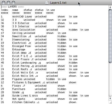

I don't know if this is useful in your circumstance, but you can go to Attribute Manager, choose Layers, select Name so the layers are in alphabetical order, then Print To File. This will create a .txt file with the layers in alphabetical order, with their current status.

You have made me so Happy
Thanks
p.s. Even better, it's in editable text format!

In ArchiCAD 7 the list is in alphabetical order, in 13 it is not, I don't know where along the way this changed (the alphabetical makes more sense, as the user has very limited control over the index numbers). [In the illustration below, 7 is on the left, 13 is on the right.] I don't know how to change the list order, changing the listing in the Layer dialog box via the headers does not change the Print output. The .txt output from the Attribute Manager seems better, as this can be imported into a text editor or Excel for further formatting.

If you explain what you are trying to accomplish, someone may have a better idea that does not require the cut-&-paste 60 times. For example, I was able to easily import the .txt file into Excel, which makes changes and reformatting simple.
