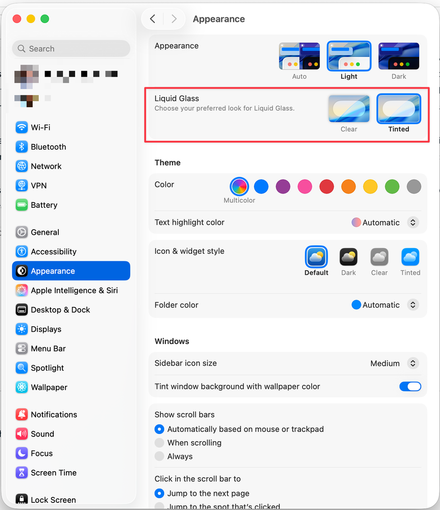

I've tested again with the MacOS setting for tinted instead of clear windows on the Liquid Glass settings, but the result is the same, I still end up with the ghost menu if I click directly on an Archicad menu after returning from my Google Chrome window on the second screen.

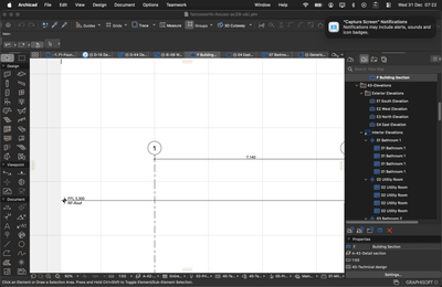

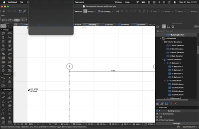

I also noticed that when I tried to capture the screen (using Parallels Toolbox) using full-screen capture the issue temporarily went away:
Using area capture it was there:
I hope all this gives ArchiCAD some more clues to help them get on top of this annoying issue. It's the only app I use that's affected. I've included some screenshots.

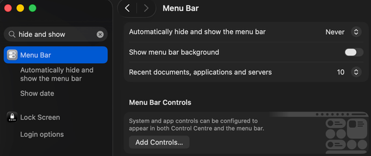

A work-around for now is to "Fill" the screen with the ArchiCAD window (from Window > Fill menu or green pill at top left). If you want the menu to show without moving mouse to top of screen use this setting:

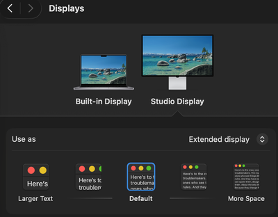

PS Here's my display setup for context:
