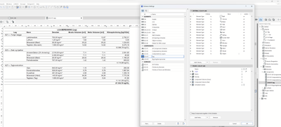

You could in fact just create a schedule that will calculate the total amount of embodied CO2 from selected elements in your project. In our danish Template we actually have a schedule showing the total amount of CO2, sorted by layers, and then a schedule sorting the amount of embodied CO2 amongst the Building components in your entire project...
(If you dont wan´t to do the schedule yourself) You can find the Template in our localization, from the link above.

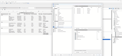

Thanks Thomas. I've had a quick play with the beta version of the plugin - it looks really promising and something we would definitely use.
In the past I have used a component schedule to do a 'quick and dirty' embodied carbon calculation (see attached - the values are nonsense, just for testing!). This uses the density and embodied carbon phyiscal properties from each building material. The calculation is simply: volume x density x embodied carbon. This gives a result in kgC02.
Using your plugin I can't yet get the same answers that I would get from my schedule. I'm guessing this is a units issue? We've been using Archicad's embodied carbon figures in kgCO2/kg. We're only looking at stages A1-A3 at the moment.
Any guidance would be super helpful. Looking forward to seeing how the plugin develops.
Cheers, Nik
Hi Nik
If you use the Material browser in DesignLCA to enter LCA values ONLY for phase A1-A3, it should automatically calculate the LCA but only for the materials with this data entered.
Please note that in DesignLCA you can enter EPD data in m2, m3 and kg, without conveting the data to a certain unit.
Have you read the DesignLCA manual? Do you need more help than this?
