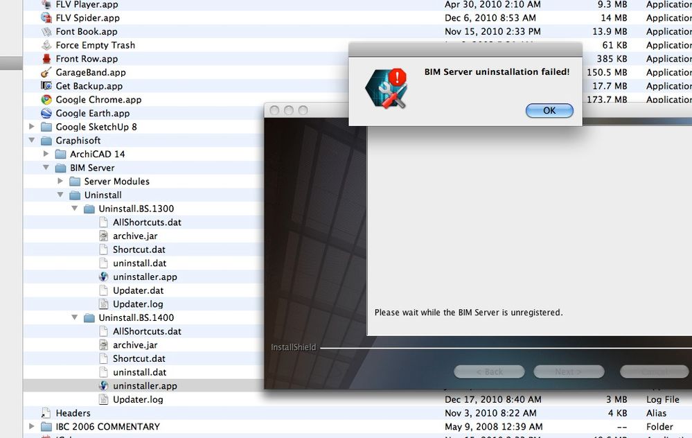

I ended up with the Bim server 13 and 14 on my system. I am now unable to remove either of them. See below. How can I get them removed?

drh64 wrote:
/... How can I get them removed?
I had a similar problem a while back Daniel.
See attached. Try this as it worked for me.
Do not delete these preferences, just put them on your desktop.
If this succeeds then trash the preferences.

Thanks. I will try that!
drh64
It worked. Thanks again.

Thanks, Rod...this worked for me trying to uninstall Bim Server 14
