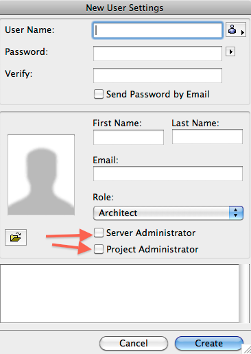

Just need some guidance regarding the BIM Server based libraries
- as these are maintained through AC13 (rather than 'BIM Server Manager') is it possible to control who can access these? I tried turning access off using a check box in role settings-refer attached screenshot-but it did not work.
Ideas anyone?

The add/remove access right that you show relates to adding/removing libraries from the TW project.
To add/remove libraries to/from the BS itself, you have to be a server administrator - separate check markunder User settings than Role selection.

Realized I probably misunderstood ... you said "access". Anybody with BS account to access the server can read any of the libraries on the server. No privacy. If you need to segregate libraries to keep some groups from seeing some libraries, you might have to install multiple BIM Servers.

Thanks Karl - I ended up testing stuff till it worked - worth noting is that I had to deselect both server and project admin to deny access to BIM Server Libraries..
I think the answer to your question is that any User with Project Administrator role can manage BIM Server Libraries.
This is done in the Manage BIM Server Libraries Dialog in ArchiCAD.
The BIM Server Manager Dialog only displays what BIM Libraries are available on the BIM Server.
There is another trick: if a User is set to be a Server Administrator he will also automatically become a Project Administrator. But you can set him/her to be Project Administrator without also having to be Server Admin.
