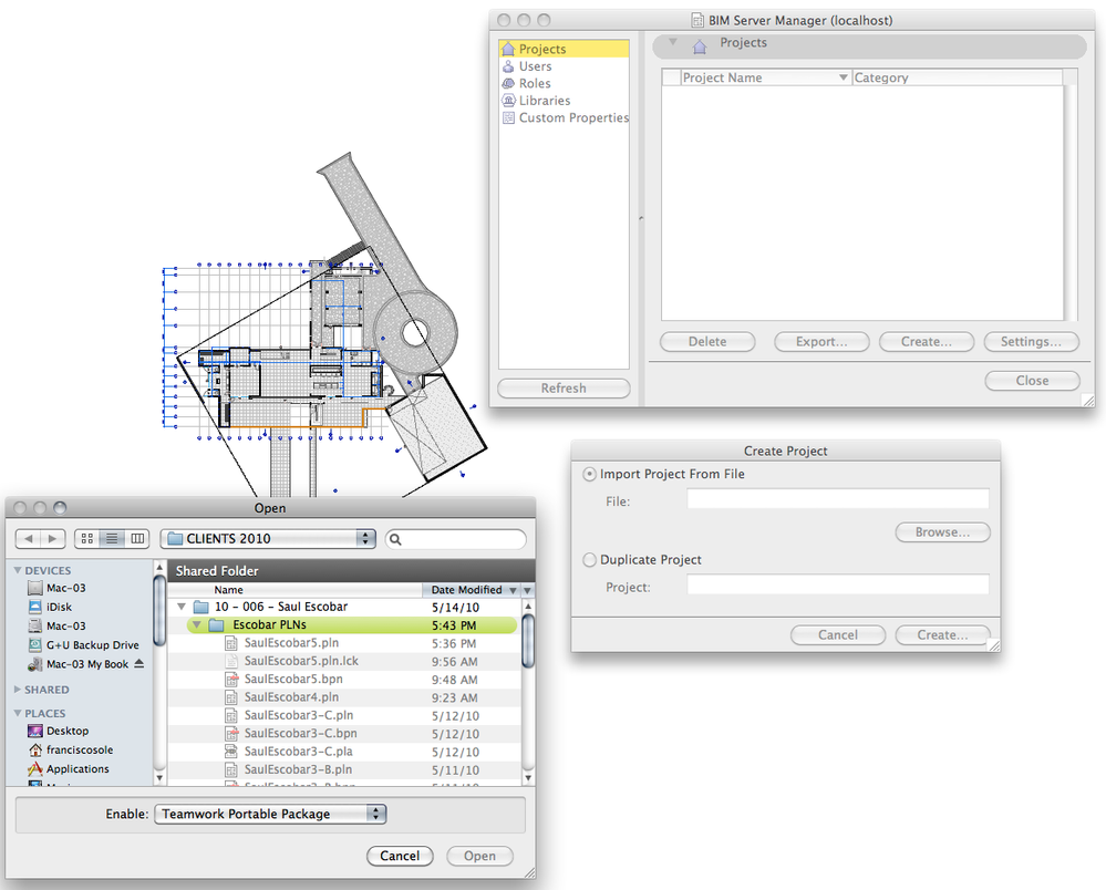

Hello, I am trying to create my first Team Work project, but I am having difficulties to create the file in the BIM Server.
Following the instructions of AC Help menu I created the BIM Server, but when comes to Create the project the PLN file is grayed out and I can't select it to start the shared Team Work file. Am I missing any step in here?

fransole wrote:
/.... Am I missing any step in here?
Have you shared your project?
See attached.
Your project is open as a solo project and from there
you share, it closes and reopens as a TW project.
