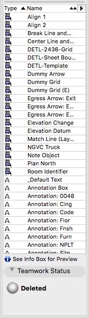

Deleted Control Light
AC19 -- never seen this before, and nothing in Help:
Favorites Palette displays a "Deleted" control light -- not too concerned because Favorites can be Imported from our Template, but curious just-the-same.
Not sure what it means, as the Favorites are still there. Members are still joined to the project in TW with no other issues.

Hi Laura,
We have not come accross a similar case before.The list can be empty, but the "Deleted" status is really strange. The only way we could imagine it to happen is if there was an error while ARCHICAD communicated with the BIM server about the existence of this favorite list object. Maybe as the program refreshed the project members list for example...(it happens in a background thread most of the time). If this issue can be reproduced, a full support package would be very much appreciated. If it pertains please follow the instructions in this article about how to create a support package! Thanks, k
