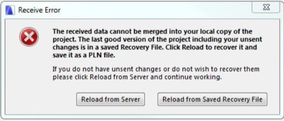

I got this error when I tried to "send and receive" in a project, I didn't read all so I just pressed "x". My project refreshed and I lost everything I've been working on since the last send and receive. Can I do something to recover what I've been working on?

If you haven’t closed and reopened Archicad the auto save version of the file may still be available on your local drive. I’m not sure where auto save files are on Windows. There will be a file there with an odd name that will be your data.
