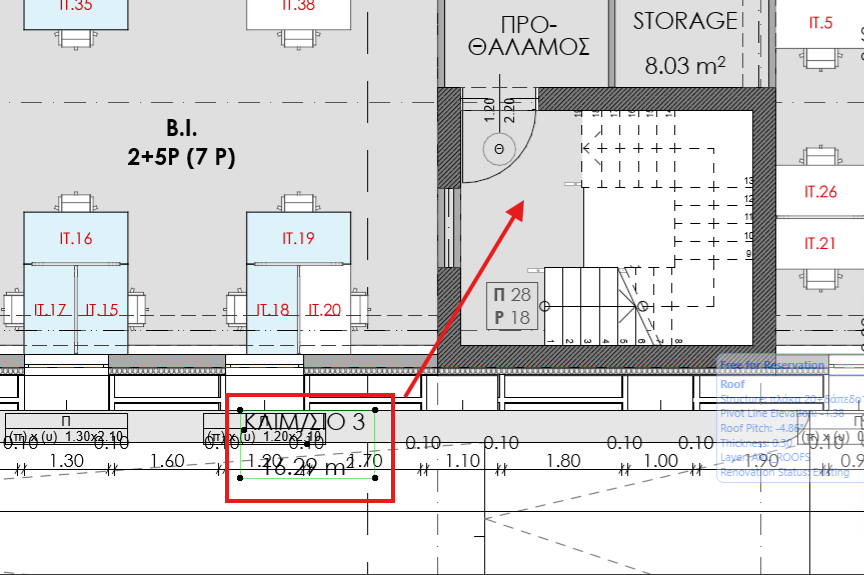

Hello everyone,
I am working in teamwork in a big project and we have placed fills with text in some areas. My colleague has manually moved the text in the right position, and we both did send & receive couple of times, but I keep seeing the text in a completely different place. We are both working in the same scale, and we have the same version (and updates) of AC. "Always readable" is selected from the Text style menu.
Below a screenshot of the problem in my computer. The text in the red frame should be in the position where the arrow points.
Any thoughts?
Thanks

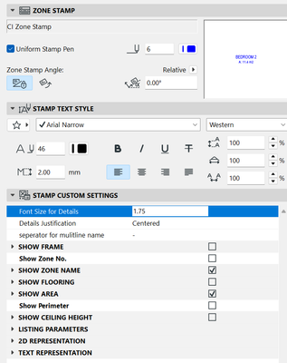

Not sure if this has been resolved for you or not. have a couple of questions  regarding the above. Are you using the fill with show area text turned on? if not try using the auto text or a linked label with auto text added such as: "#Element ID", "#Area" this would give you the name of the fill (needs to named in Element ID) and also area. as this would be a linked element, it should only move if the fill is moved (move like a fill with 'show area text' turned on)
Apologies as i am unable to read the above but i am assuming it is the room name with the area. I have only recently started using Teamwork and have not had this pop up but we have been using 'Zones' and with the CI Tools stamp:
we have not been seeing any issues with the above. benefit is this also aids with scheduling as well.  sorry could not be of more help.

It's the text from the "show area text" option of a fill. We have added the room name manually, and my colleague has moved all these texts in the right place. We have sent & received, and checked to have the same settings in terms of scale, MVO, GO etc.
Any ideas?

The main problem is that one user is seeing the fill area text in the correct spot while another no. And when we export the file it is again on the right spot. So it seems like a problem of teamwork connection (?). I am not really an expert on this, but it's the only thing I can think of, and I have no idea how this can be resolved.

Solution
Here is something you can try on the computer where the text is in the wrong place:
1. Send changes and Leave the Project.
2. Go to the Teamwork > Project > Local Data Manager and delete all Teamwork Projects and Libraries that belong to this Project.
3. Rejoin the Project.
Hopefully, this will solve the fill area text displacement issue.
Hello Laszlo,
Thank you very much. It seems to work fine now. So per my understanding, Local Data gets accumulated and might provoke problems in performance. So how often would you suggest to do that in a Teamwork project of around 5GB? And should everyone in the project do it?
