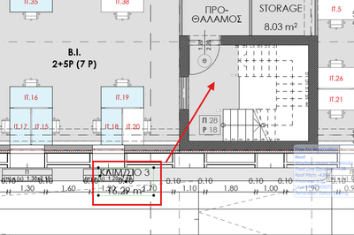

Hello everyone,
I am working in teamwork in a big project and we have placed fills with text in some areas. My colleague has manually moved the text in the right position, and we both did send & receive couple of times, but I keep seeing the text in a completely different place. We are both working in the same scale, and we have the same version (and updates) of AC. "Always readable" is selected from the Text style menu.
Below a screenshot of the problem in my computer. The text in the red frame should be in the position where the arrow points.
Any thoughts?

Here is something you can try on the computer where the text is in the wrong place:
1. Send changes and Leave the Project.
2. Go to the Teamwork > Project > Local Data Manager and delete all Teamwork Projects and Libraries that belong to this Project.
3. Rejoin the Project.
Hopefully, this will solve the fill area text displacement issue.

It's the text from the "show area text" option of a fill. We have added the room name manually, and my colleague has moved all these texts in the right place. We have sent & received, and checked to have the same settings in terms of scale, MVO, GO etc.
Any ideas?

The main problem is that one user is seeing the fill area text in the correct spot while another no. And when we export the file it is again on the right spot. So it seems like a problem of teamwork connection (?). I am not really an expert on this, but it's the only thing I can think of, and I have no idea how this can be resolved.

Solution
Hello Laszlo,
Thank you very much. It seems to work fine now. So per my understanding, Local Data gets accumulated and might provoke problems in performance. So how often would you suggest to do that in a Teamwork project of around 5GB? And should everyone in the project do it?
