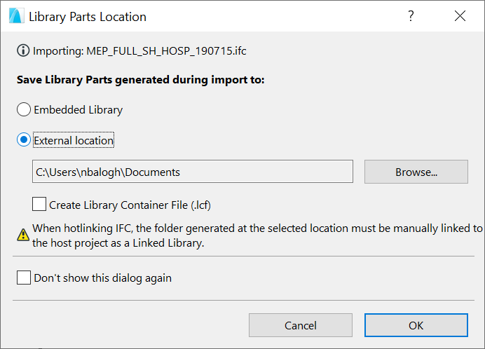

IFC Library
If your custom library contains elements from IFC, then the easiest way to migrate it is to create a library container file in the current Archicad version (.lcf).
  1. Reload the IFC file in your current Archicad version.
  2. In the Library Parts Location dialog, select External location.
  3. Check the Create Library Container File (.lcf) box.
  4. Open Library Manager (File > Libraries and Objects > Library Manager).
  5. Choose the option Add BIMcloud library... to be able to upload the library to BIMcloud.
  6. Relink your existing IFC libraries with the new Library Container Files.
  7. Delete old libraries and objects from the project (Including the Embedded Library's content).

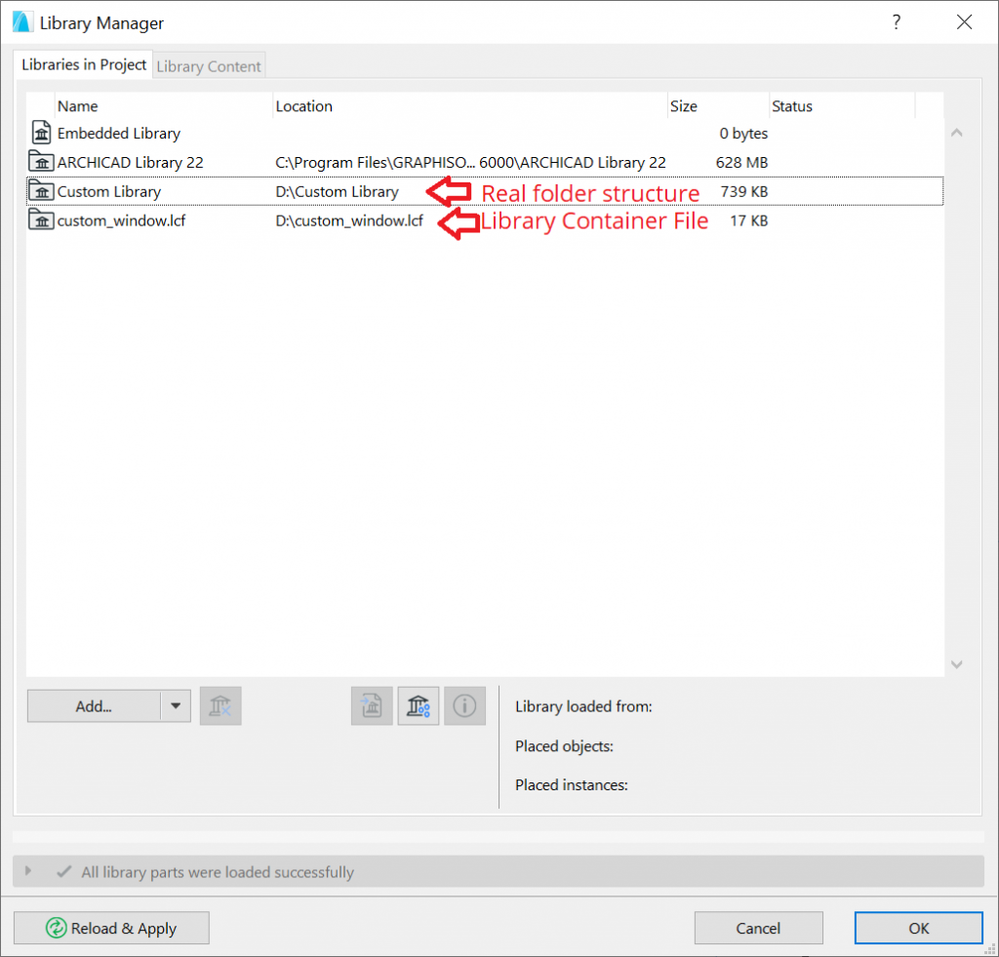

Custom Library - Office created
Another typical use case is when you create a library with certain textures, or with objects modeled in Archicad, or with GDL programming. These are either stored as .lcf files, or in a real folder structure.

In the case you chose to store your Custom Library in a Library Container File (.lcf), you first need to extract its content to be able to re-save it in your current Archicad version.
  1. Go to File > Libraries and Objects then Extract a Container...
  2. Select your custom .lcf file from the file opening dialog
  3. Browse for a new target folder.
  4. Click on OK.
  5. Follow the steps of .gsm migration mentioned above.
When you finished with re-saving all .gsm files in your current Archicad version, you can either re-create your .lcf, or you can immediately re-upload your folder to the BIMcloud. After everything is uploaded, you can delete your previous libraries from the project.
