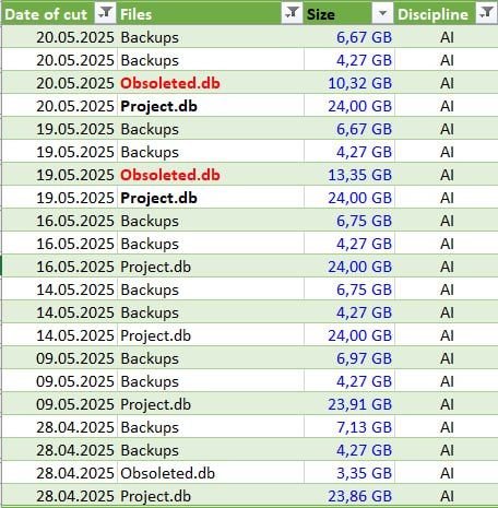

Hi!
How and why does the Obsoleted.db database file appear in the network project folder on BIMcloud 27?
Project.db and Obsoleted.db are in the same folder.
Operating system used: Windows Windows Server 2019

These obsoleted databases are normally deleted automatically by the BIMcloud Server, however in your case something prevented it. It could be an antivirus program, or another process preventing the process. As I see the size is very big in your case, so I assume you wonder if it can be deleted. Good news is that if these files are older than a day, you can freely delete them from the folder, even without stopping the BIMcloud Server for that.
