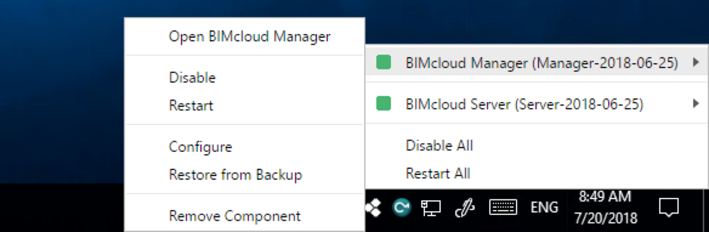

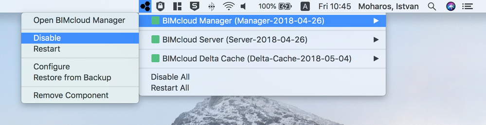

Start and Stop BIMcloud components using the BIMcloud tray icon
WindowsmacOS
To control BIMcloud components click on the BIMcloud tray icon in the Taskbar which grants quick access to manage BIMcloud services. In the pop-up panel it is possible to Enable/Disable/Restart all components at once or one by one.
To control BIMcloud components click on the BIMcloud tray icon in the Menu bar which grants quick access to manage BIMcloud services. In the pop-up panel it is possible to Enable/Disable/Restart all components at once or one by one.
