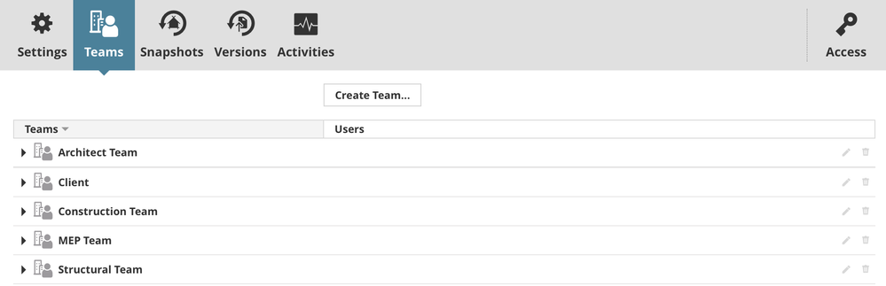

The Teams feature help BIM Managers setting up an associated project-specific permission system. It allows the creation of multiple teams, relevant to a specific BIMcloud Project. Access rights can be granted to those teams, so you can make sure each team has access only to their folder, sub-folders or files.
As shown below, the Teams tab gives the option to create multiple teams, each of them able to contain multiple members. You can create teams having the same name within several BIMcloud Projects. But they will contain different members and will apply only to the BIMcloud Project they belong to.
