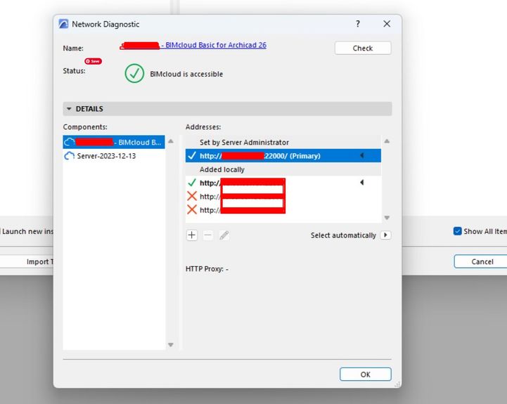

SITUATION:
We work in the office in Archicad 26 Teamwork. One of the PCs is the server, 3-4 people currently connected and working on a project.
I cannot make a 5th PC to connect and see any project. He logged in, he ran diagnostic and the server is "accessible".
PROBLEM:

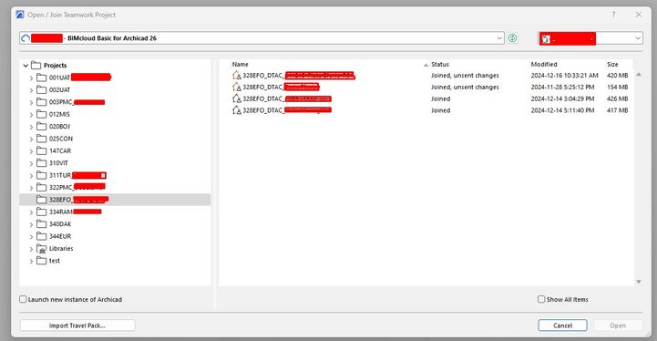

He does not see any project folders:
 Other PCs:
Any ideas what it could be ?

have you double checked the user's role. It might be, that his role doesnt allow him to see the projects.
ArchiCAD 27 GER / Win10
Masstudio
PROBLEM SOLVED.
The new user did not have a role assigned to his account and that's why he couldn't see the folders.
Masstudio
that was it.
We don't have a BIM manager and we didn't make any new account since setting up our server. Now i'm learning how these things work, i appreciate the reply
