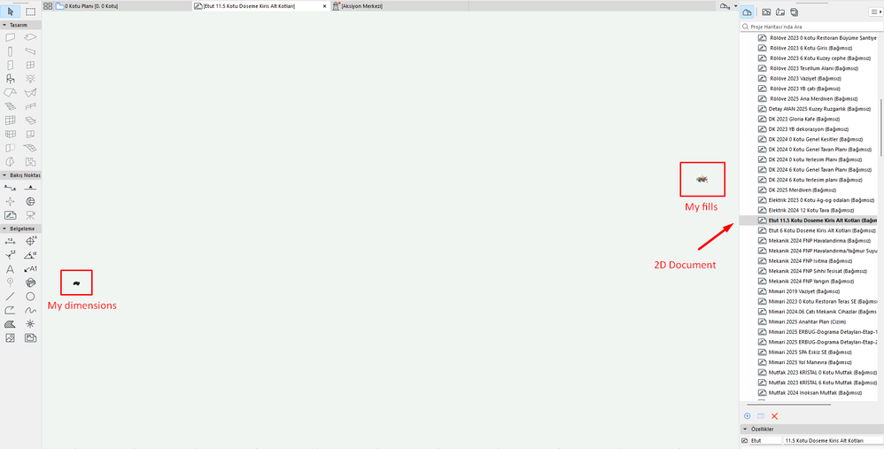

The dimensions on the 2D document went away when I save my Teamwork file as a .pln
I was working this file in Teamwork. I saved it as a .pln file to my computer after that when I open my 2D Document, I saw that the dimensions on the fills I placed had moved too far away. When I check my Teamwork file, it doesn't look like this, but in the file I saved as .pln, the dimensions have moved away. Why did this happen?

A few thoughts:
  • Based on the icons in the Navigator, those are Worksheets. Just out of curiosity: were those Dimensions static or associative? I guess if you select them now, they are static. Are they still associative in the Teamwork file?
  • Can you try to save it again as PLN and see if the result is different? Maybe it was a one-time glitch.
  • If you check the "Open & Repair selected file" option in the Open Dialog when opening the PLN files, does that solve the issue?
If this problem persists, I would recommend that you report it to your local resellers, who can forward it to Graphisoft HQ for investigation.
