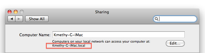

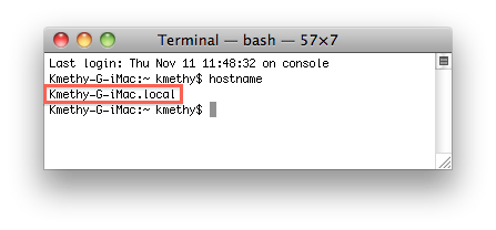

3 - Double check that the user's computer name matches its hostname on the network.
To do this go into command prompt or into terminal and type ‘hostname’ then comparing that name to the name in system preferences -> Sharing on a Mac or right click on computer and choosing properties on a PC.
  • In System Preferences, open Sharing, and under the 'Computer name' you will notice the computers local name:
  • Compare this to the name Terminal gives you, if you type the command hostname
If the two names are different, that can cause issues when trying to connect to the BIM Server. You can change your host name one of two ways:
  • First way is a permanent change of the hostname. To permanently change your hostname to 'Johns-Mac' type:
scutil –set HostName Johns-Mac
  • The other way you can change the host name is by doing a temporary host name change
Sudo hostname Johns-Mac
Once your computer name and terminal host name match try to re-connect to your BIM Server. Please note: Archicad can not handle non-standard hostnames, which can also cause the same types of connection errors.
