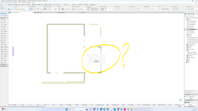

The user experiences significant delays during the startup phase of a Teamwork project in Archicad. The issue is characterized by two main symptoms:
  1. Slow Project Opening: The project takes an unusually long time to become accessible.
  2. Repeated Library Loading: The Archicad libraries are loaded from scratch every time the project file is opened, rather than being cached for faster access.
