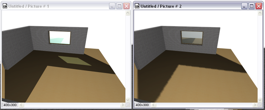

Here is an example of soft shadows in ArchiCAD.

Stefan,
Correct me if I'm wrong but in my opinion "soft shadows" have more to do with transparency then with softened edges... With less colour intensity the edges will become automaticly more vague...
Lightworks lamps are fast and easy to use rather then internal sun settings...
While using lamps, don't forget to switch off both the sun and the camera in the photorendering settings.
Lightworks sky object + 75% and sun object + 25% to start playing with...
