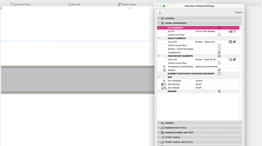

Hello everyone,
I am very new to the Archicad program. and I am really happy to join in to learn more.
I liked the idea of the appearance of the elevations with the material I select for walls and other objects. but unfortunately it worked once and then it disappeared. I tried redoing the same elevation default settings again but it shows just colors with no presenting for the real material.
can anyone please help.
Screen Shot 2022-04-23 at 11.49.40 PM.pngScreen Shot 2022-04-23 at 11.49.57 PM.pngScreen Shot 2022-04-23 at 11.50.12 PM.png

Try turning off Fade Distance Elements, or adjust the settings of Fade Distance Elements so Uncut fill is also set to "Surface - Texture Fill".

Also, make sure you don’t have any Graphic Overrides active.

Thank you for your support. I just figured out the problem!
I was changing the settings for elevations but it did not make any changes to any of the elevations. so we I entered the settings of the East elevation that is when the view changed. so apparently I need to change every elevatons' setting separately and this is what solved the problem.
