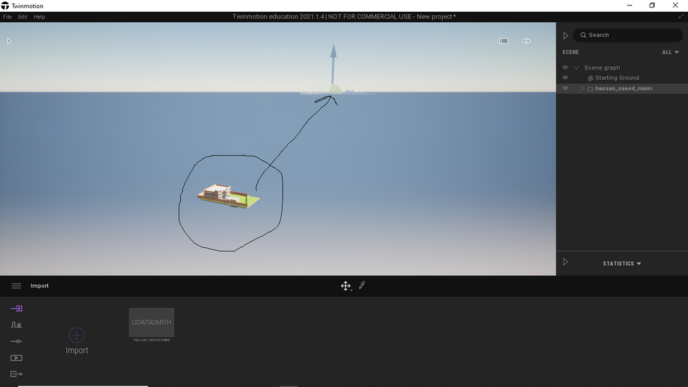

farman ali
Thank you so much! @Rex Maximilian  for your help, I have found my file in Twinmotion its imported but its far away from the middle of the scene.
How to bring it back to the middle, I have attached screenshot for your reference...
Thanks....
Best way os to relocate it in your original CAD source to be on or near the x/y 0,0.
