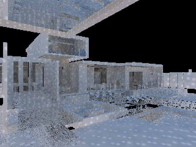

My PC was freezing when I rendering my project, must reset with the power button. It renders fine when I use quick setting, it was only append when I use middle setting. I use Maxon Cinema render. Before the freezing, the software will use all my 16G memory. My CPU is i7 8700k and GPU is GTX 1080 8G. I also use Cinema 4D, and it’s fine. I think my PC is able to do rendering with middle setting.
