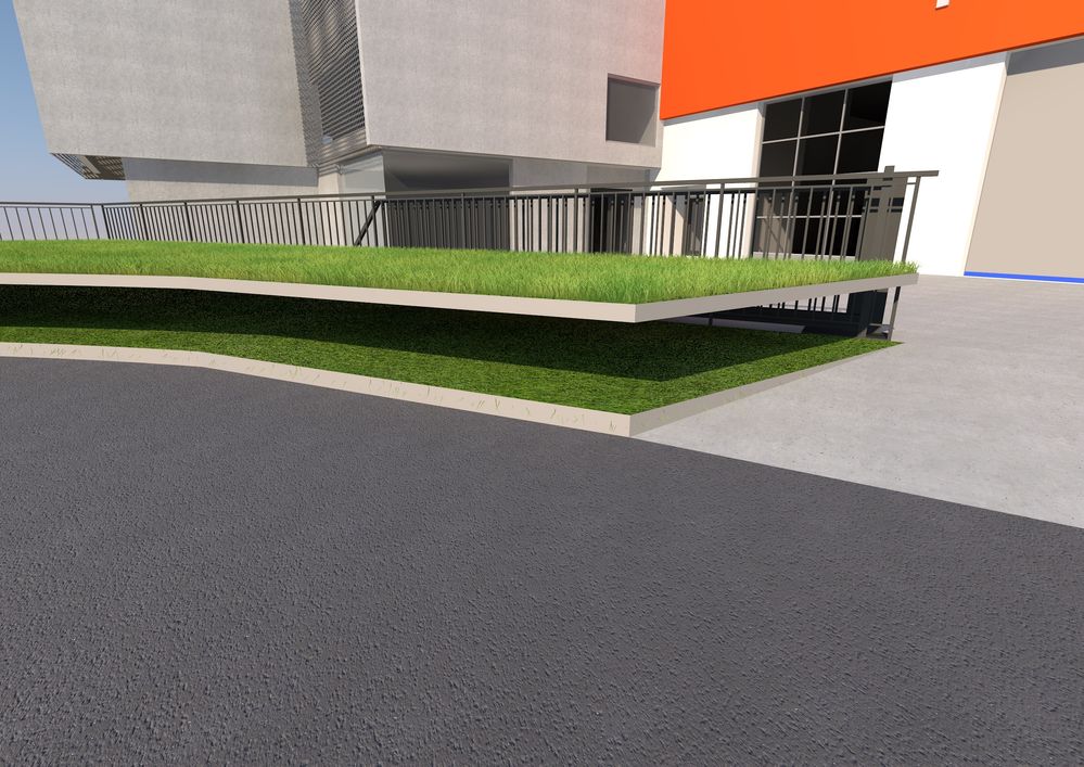

Can someone explain why the grass doesn't come out on the ground level in Archi 26 ?
I have been using the realistic 3d grass in the previous ArchiCAD versions. It should work ok.
However, it seems the grass pop up under ground. you can see the image grass coming out below the edge.
If I lift whole plane to the air, the grass begin to show up. can someone explain?

Seems to be a bug.
https://community.graphisoft.com/t5/Design-forum/Upside-down-3D-grass-in-cinerender/m-p/368009

I hate the bug >.< it is pain in the ass. I have just tested the grass plane above 1mm from G level. it works.
