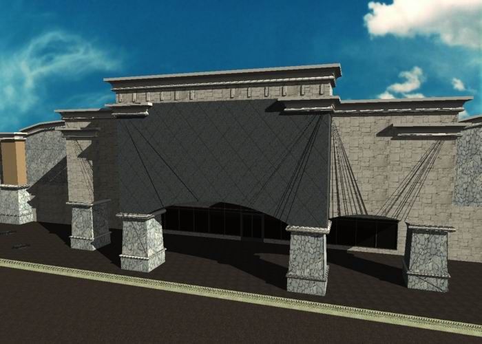

Has anyone else experienced this?
ArchiCAD 8r3 project exported to Artlantis 4.5.3.
in ArchiCAD, the model looks fine.
In ArtLantis, when shadow casting is turned on, all of these artifacts show up - they seem to be the edges of the polygons that define the face, but they cast shadows.
When I export this model into Piranesi, the 3D brushes react to these edges as though they are in a slightly different plane than the surface they are supposed to be defining - almost as though they are 'cut' into the surface.

I have had this problem before. It turned out that the model was too far away from 0,0 in ArchiCAD. I know it seems strange as the problem is in Art-Lantis, but the problem originates from ArchiCAD.
ArchiCAD has a problem dealing with elements that are placed too far away form 0,0..
Hope this helps..

That helped - thanks! I've run into that error before and fixed it by changing the origin, but the origin in previous scenes had been about 200,000 feet away from where the CAD files were imported - this scene scene was only 3,000 feet away - I hadn't considered the origin being an issue that close. I guess it is!
This project is one mile by one-half mile in size - kinda hard to find a good spot for the origin! I'll just place it right in the center...

Yea I hear what you are saying. This is still a problem in ArchiCAD. I know that GS are working very hard on a fix so that ArchiCAD is able to handle elements/objects being placed a long way from the origin,
