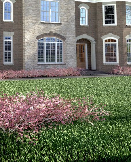

Archicad users frustrated with the indoor/outdoor carpet-like qualities of LightWorks lawn might enjoy the free ArchiRadar grass objects in their Artlantis models.
Even though the individual objects are small, it is quick enough to array an entire lawn with a variety of trimmed and wild grasses.

I found a reasonable compromise with the Dosch Design Shader with Bump turned way up.
"Natural 01"
Dwight Atkinson
Looks very good, except for the lines where the grass meets the walls.
If that line is far away enough, then it should be a winner.
