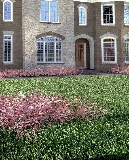

Dwight Atkinson
Dwight
i posted this during the week
Dwight Atkinson
I have been using those Archiradar free plants since 2005, when Artlantis R first came out.
Heavy, but you can achieve very passable results with them.
And free...
