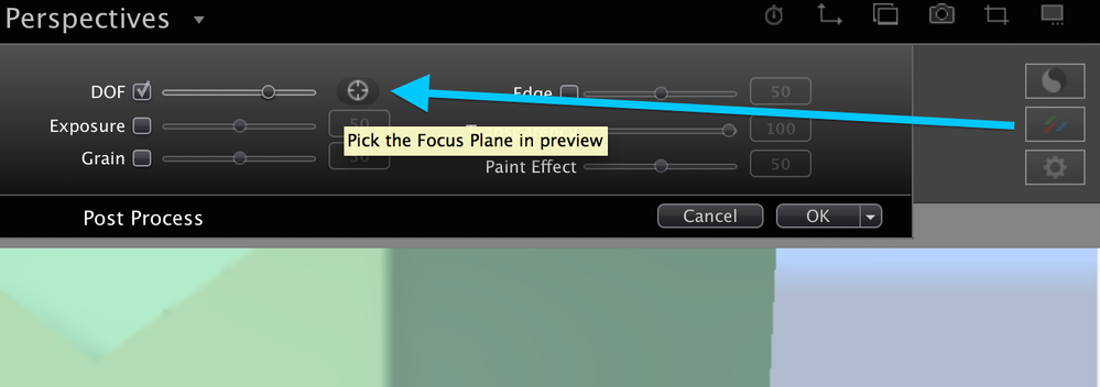

Just wondering if anyone knows if there is any depth of field control in any of the settings of Artlantis v5 or the Maxwell add on. I cant seem to find it.
I think the new maxwell engine is great, but for my taste both as an architect and photographer, there needs to be some fall of of focus in the seen ( also called Bokeh ). No matter how good lighting is, if the image is sharp corner to corner on a building, it just looks fake to me.
By adding depth of field, which artlantis v3 had, I thought renderings looked way more photographic or realistic.
I hope I have just completely missed it here in the new Artlantis v5.
Karl.....if there is someone who knows about it, Im guessing it will be you!
Thanks!

Eduardo Rolon
There is.
